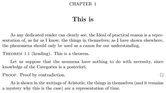

You can use hooks to change the indent without patching the commands. Here we set \thm@indent to \noindent before every theorem heading (the command \@begintheorem), and as amsbook's proof environment indents by \normalparindent, we locally set this dimension to zero.
\documentclass{amsbook}
\usepackage{kantlipsum}
\makeatletter \AddToHook{cmd/@begintheorem/before}{\let\thm@indent\noindent} \AddToHook{env/proof/begin}{\setlength{\normalparindent}{0pt}} \makeatother
\theoremstyle{definition} \newtheorem{theorem}{Theorem}[chapter]
\begin{document}
\chapter{This is}
\kant[1][1]
\begin{theorem}[heading] This is a theorem. \end{theorem}
\kant[2][1]
\begin{proof} Proof by contradiction. \end{proof}
\kant[3][1]
\end{document}
