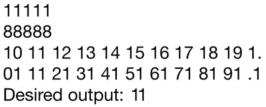

I have the problem that both the original Helvetica and the Neue Helevetica font families by Linotype, in their OpenType versions, seem to not have proportional figures, only tabular figures, where each figure is monospaced. I tried switching to proportional figures with fontspec but it doesn't change the appearance a bit.
I need the proportional figures for paragraph text where tabular figures look weird. I find this situation pretty baffling, given that it seems to be a professional and well-known font. The tabular figures are most visible with the "1", which has too much space around it.

% -*- program: lualatex  -*-
\documentclass{article}
\usepackage{fontspec}
\defaultfontfeatures{Ligatures=TeX}
\setmainfont{HelveticaNeueLTStd-Roman}
\begin{document}
\obeylines
11111
88888
10 11 12 13 14 15 16 17 18 19 1.
01 11 21 31 41 51 61 71 81 91 .1
Desired output: 1\kern-.15em{1}
\end{document}
screenshot
