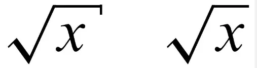

How can I get a square root looking like these in LaTeX? Thanks!

I guess you are looking for the services of the newtxmath math font package. Note that if you use it, you should probably also use the companion newtxtext text font package. Do check, though, if you want to (or are allowed to) use a Times Roman clone for your document.

  • I've already tried newpxmath, but it's still not curly enough. Thanks anyway. – Furfurr May 09 '17 at 20:30
  • @Furfurr - OK, I switched the answer to newtxmath. Any better? Maybe you should explain what you mean by "curly". – Mico May 09 '17 at 20:31
  • I’ve got the impression that $\sqrt{\mathstrut x}$ (with newtxmath) gets closer to the OP’s picture. – GuM May 09 '17 at 20:49
    @GustavoMezzetti - Thanks. I wish I understood better what "curly" is supposed to mean in the context of square root symbols. – Mico May 09 '17 at 20:53
    @GustavoMezzetti - Ah, I just noticed that the OP edited the query. I guess he/she means "curved" or "curvy" rather than "curly". – Mico May 09 '17 at 20:55
    Yes, the bar of the root is rounded at the edge: I guess this means that the radical has not been produced by TeX’s “Rule 11”, which uses a horizontal rule… – GuM May 09 '17 at 20:59
A root sign with round corners:
\documentclass{article}
\usepackage{mathptmx}
\begin{document}
\begin{equation}
\sqrt{x}
\end{equation}
\end{document}
If you want more vertical distance between the $x$ and the $\sqrt$ sign then try

Old one on the right in the image below.

  • I don't need more space in the square root, I need the square root to look curly and bold like the one in the picture. I don't know what package I have to use, but inside the square root is also Times (New) Roman font. – Furfurr May 09 '17 at 20:15
I have used, for times, \usepackage[lite]{mtpro2} and \usepackage{letltxmacro}(do you want in this mode?).
