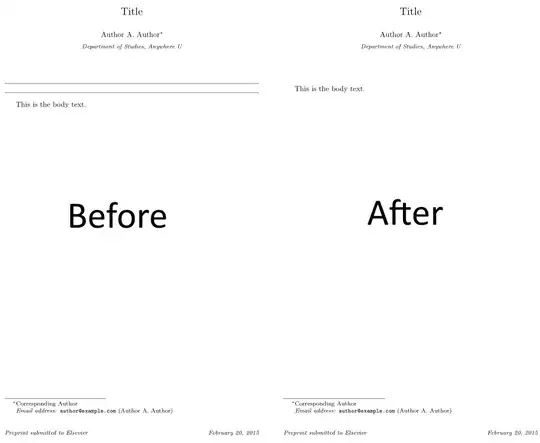

I am using the elsevier class to prepare a document.
I would like to remove the abstract environment but I can not find the way to do that. I commented out \begin{abstract} .... \end{abstract} but I still get the two horizontal lines
which enclose the abstract.

As of Feb. 2015, I found that the answer from egreg did not remove the \hrules. There is an additional macro, \pprintMaketitle in which I had to comment out the same lines of code to remove the horizontal rules around the abstract that are present even if no abstract is present.
\documentclass{elsarticle}
\makeatletter
\long\def\pprintMaketitle{\clearpage
\iflongmktitle\if@twocolumn\let\columnwidth=\textwidth\fi\fi
\resetTitleCounters
\def\baselinestretch{1}%
\printFirstPageNotes
\begin{center}%
\thispagestyle{pprintTitle}%
\Large\@title\par\vskip18pt
\normalsize\elsauthors\par\vskip10pt
\footnotesize\itshape\elsaddress\par\vskip36pt
% \hrule\vskip12pt
% \ifvoid\absbox\else\unvbox\absbox\par\vskip10pt\fi
% \ifvoid\keybox\else\unvbox\keybox\par\vskip10pt\fi
% \hrule\vskip12pt
\end{center}%
\gdef\thefootnote{\arabic{footnote}}%
\makeatother
\begin{document}
\begin{frontmatter}
\title{Title}
\author{Author A. Author\corref{cor1}}
\cortext[cor1]{Corresponding Author}
\ead{author@example.com}
\address{Department of Studies, Anywhere U}
\end{frontmatter}
This is the body text.
\end{document}
