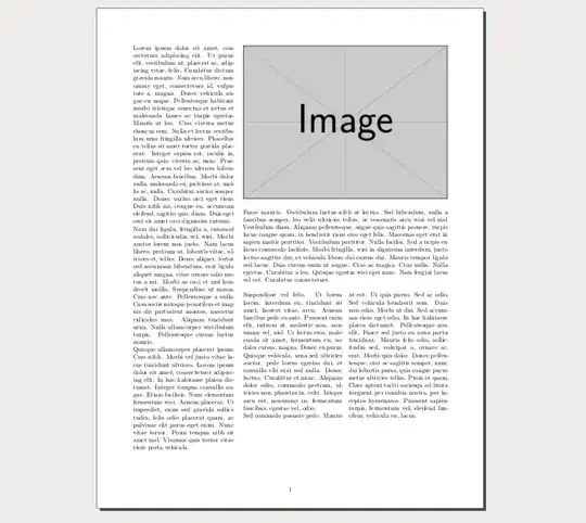

I dot not understand your problem by flowfram, as you can make layouts for several pages, but may be you find useful my question Three-columns text with figures of 2\columnwidth.
However, without this package, you can use minipages, or minipages and multicolumns:
mwe
\documentclass{article}
 \usepackage[margin=2cm]{geometry}
 \usepackage{lipsum}
 \usepackage{microtype}
 \usepackage{multicol}
\usepackage{graphicx}
\usepackage{adjustbox}
\parindent0pt
\begin{document}
\adjustbox{valign=t}{\begin{minipage}{.32\linewidth}
 \lipsum[1-2]
 \lipsum[4]
 \end{minipage}}\hfill%
\adjustbox{valign=t}{\begin{minipage}[c]{.65\linewidth}
\hfil \includegraphics[width=\linewidth]{example-image}\par\bigskip
 \lipsum[5]
\begin{multicols}{2}
 \lipsum[6-7]
\end{multicols}
\end{minipage}}
\end{document}
See also the textpos package.
