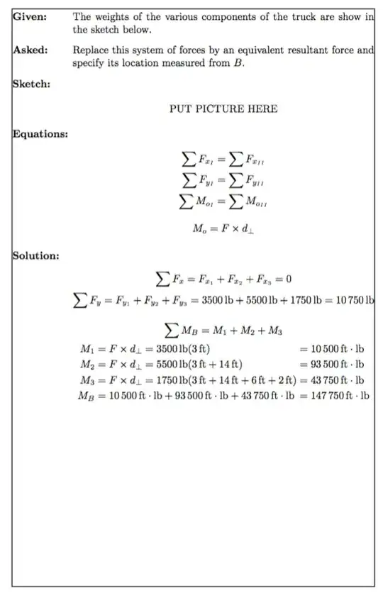

Motivation: I have developed a template to do engineering homework problems (See this question), and am now trying to encapsulate the table formating code for problems and their subsections into a \newenvironment.
The Error: When I run the appended M(N)WE, I get an error message:
! Extra }, or forgotten \endgroup.
<template> \unskip \hfil }
                          \hskip \tabcolsep \endtemplate
l.24        \begin{given}
                     The weights of the various components of the truck are ...
Question:
  1. Am I using this \newenvironment command the wrong way?
  2. Is it not possible to include the & and \\ table formating commands in a \newenvironment?
  3. What is the right way to accomplish the essence of what I am trying to do?
Attempts: So far, I have tried the following:
  • Placing the formating commands outside the \newenvironment, where I would want the macro to place them.
  • Using the environ package.
  • Using tabu instead of tabular
  • Using \tabular and \endtabular instead of \begin{tabular} and \end{tabular}
All to no avail.
Appended M(N)WE: This is the style I am trying to get to; however, it produces the error I referenced above.

MWE: Here is a version that does not use \newenvironment, but works, and represents the document I am trying to produce.

    you can not do \newenvironment{given} { \textbf{Given:} \vspace{0.125in} & }{\\} as it is like doing {\textbf{Given:}&\\} as environments form a group, you would get similar errors. (If you really want that syntax, anything is possible but it's perhaps confusing to use environment syntax for something that is not a group. – David Carlisle Feb 05 '17 at 16:05
  • Well, that unfortunately seems to answer questions 1 and 2. Any direction for 3? – Michael Molter Feb 05 '17 at 16:20
    I'll do something but not sure about the intention of \vspace{0.125in} vspace does nothing very useful in an l cell which is horizontal mode – David Carlisle Feb 05 '17 at 16:24
  • I am using it to put some vertical space between the subsections of the problem--this makes the output look a lot better when some sections only contain a single line. You can see this in the pdf image in the linked question. – Michael Molter Feb 05 '17 at 16:25
    So I guessed but the fact that adding vertical space in the first cell, in horizontal mode causes space to be added at the end of the row is a more or less accidental and definitely undocumented artefact of the implementation:-) – David Carlisle Feb 05 '17 at 16:55
  • Does your engineering course really use pounds and feet? I'm shocked! – David Carlisle Feb 05 '17 at 17:05
  • Yea, its a bit of a pain to have to remember two sets of physical constants. – Michael Molter Feb 05 '17 at 17:11
It can't work like that: environments form groups.
On the other hand, you're using the wrong tools, in my opinion. Rather than a tabular you should use an itemized list.
I changed unit into the more powerful siunitx package.

Note that the box is due to showframe; remove the package and it will go away.
Please, avoid $$ in LaTeX.
With a small modification, you can even give an optional font size argument to the environment, in order to accommodate a particularly long problem.

  • This approach seems to do the trick. Are there any consequence or benefits to using minipage in this context, other than that it just works of course! Thank you. – Michael Molter Feb 05 '17 at 16:58
  • One difference with respect to tabular is that now the parts of the problem can move to the second page. You can't break a minipage in the middle though (and if you want to you'll have to find another minipage like command like tcolorbox for that). – Sergei Golovan Feb 05 '17 at 17:02
    Or itemize as it was suggested by @egreg. Note though that if you start an item by a display formula \item introduces an additional vertical gap. – Sergei Golovan Feb 05 '17 at 17:06
The outer tabular isn't really helping, but if you want a table, you could do something like this, using an environment syntax for the parts is particularly tricky if you are embedding in a table as each cell is then a separate group and you are starting an environment in one cell and ending in another.
\documentclass[10pt]{article}
\usepackage{units}
\usepackage{amsmath,array}
\newenvironment{problem}{%%
    \noindent
    \hspace{-1in}%
    \begin{tabular}{>{\bfseries}l p{5.5in}}%%
    \end{tabular}%%
    \par
    \pagebreak
\begin{document}
    \pagestyle{empty}
\setlength\extrarowheight{.125in}
    \begin{problem}
Given&
 The weights of the various components of the truck are show in the sketch below.
Asked&
 Replace this system of forces by an equialent resultant force
and specify its location measured from $B$.
Sketch&
\begin{center} PUT PICTURE HERE \end{center}
Equations&
{\begin{align*}
            \sum F_{x_I} &= \sum F_{x_{II}}
            \sum F_{y_I} &= \sum F_{y_{II}}
            \sum M_{o_I} &= \sum M_{o_{II}}
\end{align*}}
            \vspace{.0625 in}
            \[M_o = F\times d_\perp\]
Solutions&
{\begin{align*}
            \sum F_x &= F_{x_1} + F_{x_2} + F_{x_3} = 0\\
            \sum F_y &= F_{y_1} + F_{y_2} + F_{y_3} =
\unit[3500]{lb} + \unit[5500] {lb} + \unit[1750]{lb} = \unit[10\;750]{lb}
\end{align*}}
            \vspace{.0625 in}
            {\begin{align*}
\sum M_B = M_1 + M_2 + M_3\\
                M_1 &= F\times d_\perp = \unit[3500]{lb}(\unit[3]{ft}) &= \unit[10\;500]{ft\cdot lb} \\
                M_2 &= F\times d_\perp = \unit[5500]{lb}(\unit[3]{ft}+\unit[14]{ft}) &= \unit[93\;500]{ft\cdot lb} \\
                M_3 &= F\times d_\perp = \unit[1750]{lb}(\unit[3]{ft}+\unit[14]{ft}+\unit[6]{ft}+\unit[2]{ft}) &= \unit[43\;750]{ft\cdot lb} \vspace{.0625in} \\
                M_B &= \unit[10\;500]{ft\cdot lb} + \unit[93\;500]{ft\cdot lb} +  \unit[43\;750]{ft\cdot lb} &=  \unit[147\;750]{ft\cdot lb}
            \end{align*}}
    \end{problem}
\end{document}
David Carlisle
  • 757,742
I would do it as a description environment with specialised items (\Given, \Asked,&c.), put in an \eqparbox so they all use the largest width of them. In addition, I replaced the many $$ … $$, which you should not use with latex, with the relevant amsmath environments. Note this environment can break across pages.
\usepackage{amsmath, units}
\usepackage{enumitem, eqparbox}%%%
\newlength\itemwd
\settowidth{\itemwd}{\textbf{Equations}}
\newcommand\Given{\item[\eqparbox{Pb}{Given: }]\leavevmode}
\newcommand\Asked{\item[\eqparbox{Pb}{Asked: }]\leavevmode}
\newcommand\Sketch{\item[\eqparbox{Pb}{Sketch: }]\leavevmode}
\newcommand\Eqns{\item[\eqparbox{Pb}{Equations: }]\leavevmode}
\newcommand\Sol{\item[\eqparbox{Pb}{Solution: }]\leavevmode}
 \begin{document}
\begin{description}[leftmargin =\eqboxwidth{Pb},labelsep = 0pt]
    \Given The weights of the various components of the truck are show in the sketch below. \\
    \Asked Replace this system of forces by an equialent resultant force and specify its location measured from $B$. \\
    \Sketch
        \begin{center}PUT PICTURE HERE\end{center}
    \Eqns \vspace{-\dimexpr\abovedisplayskip+\baselineskip\relax}
    \begin{align*}\sum F_{x_I} & = \sum F_{x_{II}}\\%
    \sum F_{y_I} & = \sum F_{y_{II}}\\%
    \sum M_{o_I} & = \sum M_{o_{II}}
       \\[2ex]
        M_o & = F\times d_\perp
\end{align*}
   \Sol \vspace{-\dimexpr\abovedisplayskip+\baselineskip\relax}%
   \begin{gather*}\sum F_x = F_{x_1} + F_{x_2} + F_{x_3} = 0\\
            \sum F_y = F_{y_1} + F_{y_2} + F_{y_3} = \unit[3500]{lb} + \unit[5500] {lb} + \unit[1750]{lb} = \unit[10\;750]{lb}\\[2ex]
           \sum M_B = M_1 + M_2 + M_3\\[2ex]
   \begin{alignedat}{2}
 M_1 &= F\times d_\perp = \unit[3500]{lb}(\unit[3]{ft}) & &= \unit[10\;500]{ft\cdot lb} \\
 M_2 &= F\times d_\perp = \unit[5500]{lb}(\unit[3]{ft}+\unit[14]{ft}) & &= \unit[93\;500]{ft\cdot lb} \\
 M_3 &= F\times d_\perp = \unit[1750]{lb}(\unit[3]{ft}+\unit[14]{ft}+\unit[6]{ft}+\unit[2]{ft}) & &= \unit[43\;750]{ft\cdot lb} \\[2ex]
 M_B &= \unit[10\;500]{ft\cdot lb} + \unit[93\;500]{ft\cdot lb} + \unit[43\;750]{ft\cdot lb} & & = \unit[147\;750]{ft\cdot lb}
 \end{alignedat}
\end{gather*}%
\end{description}
\end{document}
Bernard
  • 271,350
