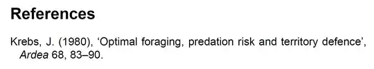

It does change because this is simply what that particular style does in the BibTeX layer. You can see easily what happens if you look into the derived .bbl:
\begin{thebibliography}{xx}
\harvarditem{Krebs}{1980}{krebs1980optimal}
Krebs, J.  \harvardyearleft 1980\harvardyearright , `Optimal foraging,
  predation risk and territory defence', {\em Ardea} {\bf 68},~83--90.
\end{thebibliography}
The '68' is inside a group in which the (obsolte) font command \bf is issued, which formats the groups content bold. You can try

You can quite easily modify the bst file.
  1. Find the file agsm.bst in your TeX system
  2. Copy it in the same folder as your .tex document, with the name agsm-nobf.bst
  3. Open the new file with any text editor
  4. Find in it the only line containing the string \bf
  5. Edit so that it becomes
    FUNCTION {embolden}
    { duplicate$ empty$
        { pop$ "" }
    %    { "{\bf " swap$ * "}" * }
        { "{" swap$ * "}" * }
      if$
    (I left the original one, but commented out, for future memory)
Now your file can become

A few things to note. I removed \sloppy and you should do it as well. The filecontents* environment is just for convenience here, in order to make the example self-contained; you'll use your bibliography.bib file, but the call should be
\bibliography{bibliography}
without .bib.
Compile, run BibTeX and compile again.
egreg

  • The only place where the embolden function is used in agsm.bst is inside the format.vol.num.pages function, on the line that reads { volume embolden field.or.null. An alternative to the approach you provide would be to change the preceding line to { volume field.or.null. That said, both approaches produce the exact same output. :-) – Mico Jan 19 '17 at 00:36
  • @Mico I went for a minimal patch; I thought about removing embolden, but my command of the bst language is limited. – egreg Jan 19 '17 at 00:44
