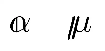

I also spent a lot of time on the issue and found nothing satisfactory. So I made up my own blackboard bold mu and alpha:
\documentclass{minimal}
\usepackage{amssymb}
\newcommand{\Balpha}{\mbox{$\hspace{0.12em}\shortmid\hspace{-0.62em}\alpha$}}
\usepackage{xcolor}
\usepackage{graphicx}
\newcommand{\Bmu}{\mbox{$\raisebox{-0.59ex}
  {$l$}\hspace{-0.18em}\mu\hspace{-0.88em}\raisebox{-0.98ex}{\scalebox{2}
  {$\color{white}.$}}\hspace{-0.416em}\raisebox{+0.88ex}
  {$\color{white}.$}\hspace{0.46em}$}{}}
\begin{document}
$\Balpha\quad\Bmu$
\end{document}
This produces
blackboard bold alpha and mu
(source: uni-muenster.de)
Urs Hartl
  • 101
