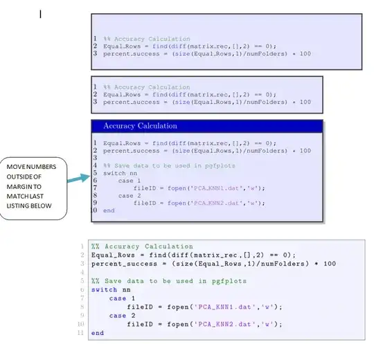

The question is building off the solution give here.
How do you remove the mcode package so that listings 1 - 3 will have the Matlab code that resembles the last listing and also contain the line numbers outside of the box :
Here is the original solution as given by hbaderts:

If you just want to move the numbers, a quick hack could be to use numbersep=25pt or similar. However this will not change the margins around the code block, they will still be different then in the last code block.

EDIT:
For the first box, the margins can be adjusted as the following:
