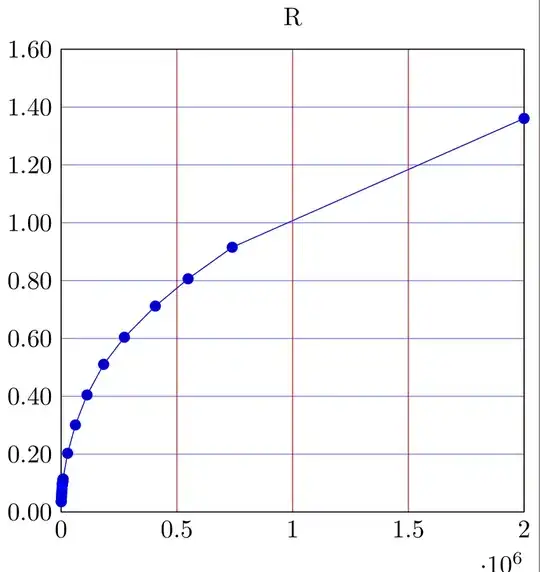

I wonder why minor ticks are not displayed even though
    minor y tick num=4
was specify when I use pgfplots.I know there is a way to manually add the minor y tick by
    minor ytick={0.04,0.08,...,1.6}
but I want it added automatically because lots of data like the table listed below are waiting to be processed .Here is my minimal work code

Which produce This is what I get
As you can see,the minor y tick not shown as expected.Any suggestion will be appreciated.Thanks a lot.
  • It seems that this is a precision problem of the ytick calculation. If you change the precision setting of yticklabel style to 5, then you can see that there are rounding problems. So may be the major ticks don't have exactly the same distance. Try ytick distance=.2 instead ytick={0,0.2,...,1.6} – esdd Oct 26 '16 at 07:06
  • Thanks a lot. Set ytick distance=.2 Solve my problem.Great appreciate. – Cong Yang Oct 26 '16 at 14:52
