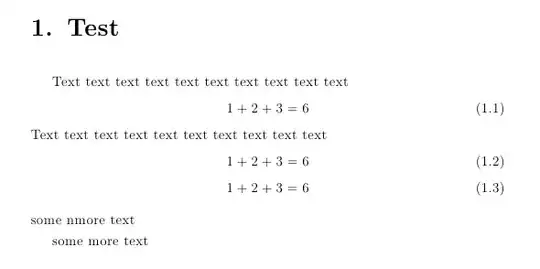

you should use package setspace for the vertical spacing. The distance between two equations is set by the short skips!
\documentclass[12pt,a4paper]{mwrep}
\usepackage{setspace}\onehalfspacing
\AtBeginDocument{%
  \addtolength\abovedisplayskip{-0.5\baselineskip}%
  \addtolength\belowdisplayskip{-0.5\baselineskip}%
%  \addtolength\abovedisplayshortskip{-0.5\baselineskip}%
%  \addtolength\belowdisplayshortskip{-0.5\baselineskip}%
\begin{document}
\chapter{Test}
Text text text text text text text text text text
\begin{equation}
1 + 2 + 3 = 6
\end{equation}
\begin{equation}
1 + 2 + 3 = 6
\end{equation}
\begin{equation}
1 + 2 + 3 = 6
\end{equation}
some nmore text\par
some more text
\end{document}
