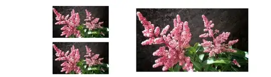

I used the LaTeX code below to place three images in a document.
\documentclass{article}
\usepackage{graphicx}
\usepackage{wrapfig}
\graphicspath{ {images/} }
\begin{document}
\begin{wrapfigure}{r}{0.5\textwidth} %this figure will be at the right
    %\centering
    \includegraphics[width=0.5\textwidth]{image1}
\end{wrapfigure}
\begin{wrapfigure}{l}{0.5\textwidth}
    \centering
    \includegraphics[width=0.25\textwidth]{image1}
\end{wrapfigure}
    \centering
\end{wrapfigure}
\end{document}
I expected one large image on the right hand side and two images on the left. But this code doesn't seem to do that. I wish to know the error if possible.
This code works but only when there is text.
I understand there are other methods to do so, but I am highly interested in knowing the mistake in this code as I am new to LaTeX.
Current output:
Expected output:

I can't fully reproduce your output since I don't have the image1 graphic. I'd like to make the following suggestions, though:
  • Insert a \noindent directive immediately before the first \begin{wrapfigure} statement.
  • Don't leave blank lines between the three wrapfigures. Remember: when TeX is in (so-called) horizontal mode, blank lines are indicators of paragraph breaks. If you don't want to generate a paragraph break, don't provided blank lines.
  • Add % (comment characters) immediately after the first and second \end{wrapfigure} statements. For the example at hand, this measure isn't strictly necessary, but it may come in handy for other wrapfigure widths.
\usepackage[demo]{graphicx} % remove 'demo' option in real document
\begin{document}
\noindent
\end{wrapfigure}%
    \centering
\end{wrapfigure}%
    \centering
\end{wrapfigure}
\end{document}
Addendum: The wrapfigure environment isn't really meant for the type of work done in this example document. To get finer control over the positioning of the elements, I recommend you not use wrapfigure environments at all and, instead, simply place the images on the left into a minipage environment and place the image on the right in a separate minipage. The two minipage environments will automatically be centered vertically relative to each other; I think that's what you want.
\begin{document}
\noindent
\begin{minipage}{0.5\textwidth}
  \centering
  \includegraphics[width=0.5\linewidth]{image1}
  \medskip % note the blank line immediately above this line
\end{minipage}%
  \includegraphics[width=\linewidth]{image1}
\end{minipage}
\end{document}

  • I apolagise for not including the image1. But here is a link to download the same. https://drive.google.com/file/d/0B-Z4fjNozQQWV3BqVkl6d2hiY0E/view?usp=sharing
    I incorperated your comments. It seems to have solved about 80% of my problem. But the first top lmage is starts a bit below than the right hand side image. It can be viewed from this image. https://drive.google.com/file/d/0B-Z4fjNozQQWM2VRc0NvSkozeGs/view?usp=sharing
    – Denis Sep 04 '16 at 06:41
  • im sad that my outputs are weird. I am coming from C language background. I want latex to do exactly what its told. It seems its a but complex. Could you please tell me a source from which I can really learn to solve this sort of complex problems? – Denis Sep 04 '16 at 06:43
  • @Qwertylicious - Is there a particular (and good) reason for using wrapfigure environments to place the three images? IMNSHO, It would be much more straightforward to use a minipage to encase the two images on the left and anotherminipage for the image on the right. I've posted an addendum to show how this might be done. – Mico Sep 04 '16 at 06:50
  • According to logic, I expected my latex code to work. As I am new to latex i am deciding whether i am able to use it. I love documents made with latex. But if I am to use it, I want it to do exactly what I say. When it did something like this ( question) I just didnt know what to do. Could you please tell why it didnt work as expected? – Denis Sep 04 '16 at 06:56

  • @Qwertylicious - I honestly don't know all the details of how wrapfigure environments are placed on a page. I'm pretty sure, though, that it's not optimal to use them for the example at hand. With a lot of hard work and applying various ad-hoc solutions, it's probably possible to get the images to be placed exactly the way you want even with various wrapfigures. But why pursue this approach if the minipage approach is entirely straightforward? – Mico Sep 04 '16 at 07:01
