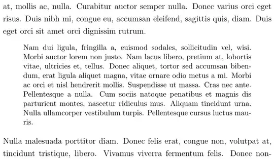

As suggested in ahogen's answer, csquotes is a great way to typeset all sorts of quotations.
One of the simplest ways to customise csquotes' block quotations is via \SetBlockEnvironment and a custom environment based on quote.
Unfortunately, we need to define a new helper command to enter singlespacing without space correction (\singlespacingNoVspace), since we already have enough space added by quote.
\documentclass[12pt]{article}
\usepackage{csquotes}
\usepackage[onehalfspacing]{setspace}
\makeatletter \newcommand*{\singlespacingNoVspace}{% \setstretch{\setspace@singlespace}} \makeatother
\newenvironment{singlequote} {\quote\small\singlespacingNoVspace} {\endquote}
\SetBlockEnvironment{singlequote}
\usepackage{lipsum} % for dummy lorem ipsum text
\begin{document} \lipsum[1] \begin{displayquote} \lipsum[2] \end{displayquote} \lipsum[3] \end{document}
one-half spaced surrounding text, single-spaced quote
