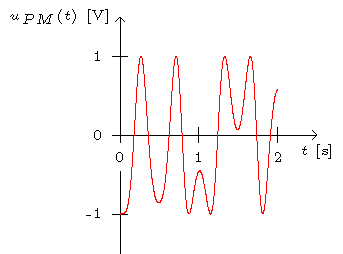

I'm trying to plot a graph of a composed function in form x(t) = cos(t+ cos(t)) using only TikZ without PGFplots, but the result is incorrect.
Incorrect result
(source: mrak.cz)
The used code is:

\draw [variable=\t, domain=0:2, samples=401, smooth, red] plot (\t, {cos(2*pi*10*\t + pi*cos(2*pi*1*\t r) r)}); % "r" v argumentu kosinu znamená, že argument je v radiánech
\end{tikzpicture}
\end{document}

Am I doing something wrong or TikZ just can not plot those types of functions?
ska109
  • 63
    The r operator has the same priority than multiplications and divisions. So, 2 + 3 r is equal to 2 + (3 r). You may use parentheses : (2 + 3) r... – Paul Gaborit Aug 17 '16 at 09:05
you have misamtch in \cos argument, it should be
cos((2*pi*10*\t + pi*cos(2*pi*\t r)) r)
(observe parenthesis):

\draw [variable=\t,domain=0:2,samples=401,smooth,red]
    plot (\t,{cos((2*pi*10*\t + pi*cos(2*pi*\t r)) r)});
