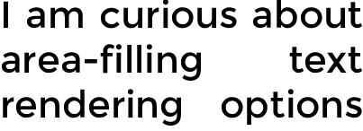

Thankfully, very similar problems have been solved. Here is an adaptation:

lualatex solution
This was processed with lualatex.
