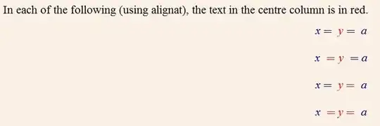

In response to a comment, I tried putting the "=" sign at all possible positions. Here are the 4 permutations.
The result is not as desired:

  • @TorbjørnT. Please see the two screenshots I added and let me know what you think. I have tried putting the = sign at all possible positions and it is still not as desired. –  Apr 04 '16 at 11:03
