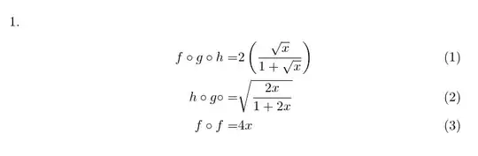

Do you want something vaguely like this?
grouped equations
\documentclass{article}
\usepackage{amsmath}
\begin{document}
  \begin{enumerate}
    \item
    \begin{align}
      f \circ g \circ h =& 2\left(\frac{\sqrt{x}}{1+\sqrt{x}}\right)\\
      h \circ g \circ =& \sqrt{\frac{2x}{1+2x}}\\
      f \circ f =& 4x
    \end{align}
  \end{enumerate}
\end{document}

  • Yes, I just got this to work in my own document. I take it that \item is an indicator for the enumerate environment? – Alex Clough Mar 01 '16 at 03:49
  • @AlexClough \item increments the counter and prints the value (simplistic explanation I think), but yeah it's what causes the number to be there. But the great thing about it is it also takes care of the numbering. So if you have an (a) and a (b) and then you wanna stick an item in between them, you just put your cursor between them, add in another \item put whatever you wanna put and it will automatically renumber everything for you. Same as if you wanna reorder (a) and (b) and then if you ever wanna refer to (a) again, it can do that automatically too – Au101 Mar 01 '16 at 03:54
  • @AlexClough \item indicates an item in a list. The enumerate tells LaTeX that the list items should be numbered. If you used the itemize environment, the \item would get you something like a bullet instead. – cfr Mar 01 '16 at 12:49
