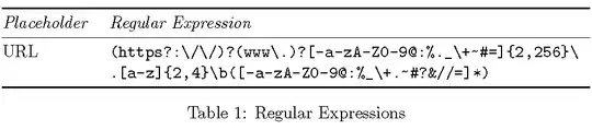

As @DavidCarlisle has already indicated in a comment, you could proceed as follows: Use a tabular environment instead of a tabularx environment, use the p column type for the second column, and calculate its width using information about the width of the first column. This setup would allow the use the \url macro to typeset the long regexp string as if it were a URL string.
In the example below, using { and/or } is permissible because even though these characters occur in the regex string, they occur in the right order and are balanced. If this weren't the case, i.e., if the curly braces were unbalanced, one would have to use a character that doesn't occur anywhere in the regex string; e.g., \url!...! and \url M...M would both work since neither ! nor M occur in the regex string.

\begin{tabular}{@{} l p{\lengthb} @{}}
    \toprule
    \emph{Placeholder}&\emph{Regular~Expression}\\
    \midrule
    URL&  \url{(https?:\/\/)?(www\.)?[-a-zA-Z0-9@:%._\+~#=]{2,256}\.[a-z]{2,4}\b([-a-zA-Z0-9@:%_\+.~#?&//=]*)} \\
    \bottomrule
\end{tabular}
\caption{Regular Expressions}
\label{regex}\end{table}
\end{document}
