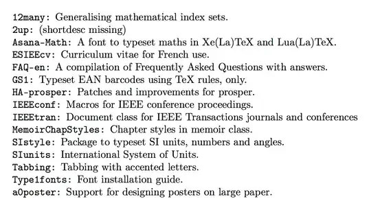

A pdflatex version; run with -shell-escape.
\documentclass{article}
\usepackage[T1]{fontenc}
\usepackage{xparse}
\ExplSyntaxOn
\NewDocumentCommand{\listpackages}{}
  \krlmlr_list_packages:
\ior_new:N \g_krlmlr_read_stream
\cs_new_protected:Nn \krlmlr_list_packages:
  \ior_open:Nn \g_krlmlr_read_stream { |"tlmgr~list~--only-installed" }
  \ior_map_inline:Nn \g_krlmlr_read_stream
    \__krlmlr_process_line:n { ##1 }
\cs_new_protected:Nn \__krlmlr_process_line:n
  \__krlmlr_process_line_aux:w #1 \q_stop
\cs_new_protected:Npn \__krlmlr_process_line_aux:w #1~#2~#3 \q_stop
  \noindent\texttt{\tl_to_str:n { #2 }}~\tl_to_str:n {#3}\par
\ExplSyntaxOff
\begin{document}
\listpackages
\end{document}
(Just the first few entries and not the whole 76 pages.)
