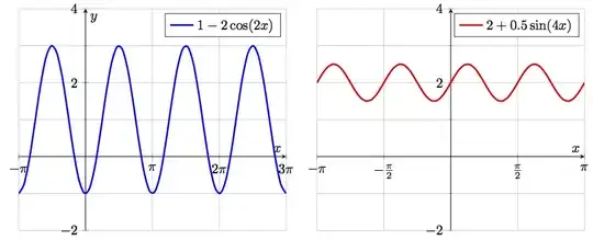

Using pgfplots, I often want to label the horizontal axis major ticks in units of pi or pi/2, or pi/3. Is it possible to have such "trigonometric major ticks" use minor tick num = <value> to specify the number of minor ticks?
Currently my approach for "trigonometric major ticks" is to make a style wholes that specifies the xtick=<integer multiples of pi> and xticklabels=<labels>. I specify the ticks for a range -4*pi to +4*pi, and crop the graph as needed. I similarly have a style called halves for half-integer multiples of pi:

with output
Problem: I'm fairly happy with this solution, except minor tick num=1 is not working on the x-axis. I think this is due to rounding errors. Minor grid in pgfplot not showing when specifying ticks manualy
Certainly I could specify the minor ticks manually. I really don't want to do this---I need to create many graphs like this, some times I want minor tick num = 1, sometimes I want minor tick num = 3.
Is there a better approach?
