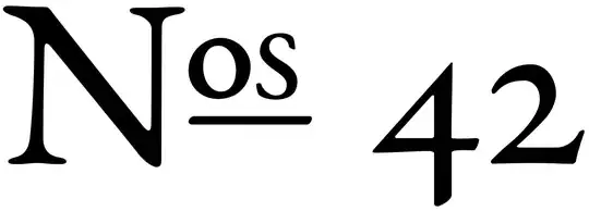

Not convinced about the usefulness, but
\documentclass{article}
\def\numeros{N{\raisebox{0.2ex}{\textsuperscript{\underline{os}}}}}
\begin{document}
\section*{\numeros}
\end{document}
works:
Numeros
