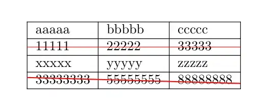

With {NiceTabular} of nicematrix, you can easily strike a row with TikZ by using the nodes created by nicematrix.
\documentclass{article}
\usepackage{nicematrix,tikz}
\begin{document}
\begin{NiceTabular}{lll}[hvlines] aaaaa & bbbbb & ccccc \ 11111 & 22222 & 33333 \ xxxxx & yyyyy & zzzzz \ 33333333 & 55555555 & 88888888 \ \CodeAfter \tikz \draw [red] (2.5-|1) -- (2.5-|last) ; \tikz \draw [thick,red] ([yshift=-4pt]4-|1) -- ([yshift=4pt]5-|last) ; \end{NiceTabular}
\end{document}
Output of the above code
F. Pantigny
