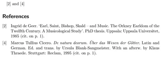

Here is a solution using the docmute package.
The idea is to import the other document in a savebox but not actually typeset it. In order to be able to print only those entries cited in our actual main document we will have to use a refsegment. To ensure that all defernumbers features work as expected we also always print the bibliography from the the other document to make sure the numbering is fine.

We then have a command \importcites which takes the file name of the .tex document we want to import the citations from. Use it directly after \begin{document} of your main file.
In the example setup \jobname.tex corresponds to your file B, and \jobname-ext.tex is file A. The technical machinery needs to reside in file B, file A is only ever mentioned in \importcites. You will have to call \printbibliography in file B with segment=\therefsegment (or segment=0) to work properly. If you omit the segment argument you will get to see the references of file A as well.

example output

  • Thanks. It mostly worked with some caveats: (1) I had to comment out float environments in the A document, otherwise I would get errors, (2) docmute apparently drops the preamble of A, so I had to move those definitions to the preamble of B, (3) I use hyprref package to make the citations hyperlink so that they jump to the reference list once clicked. This didn't work in B, and I assume it is because they point to ref. list in A somehow? It would be really nice if (3) can be fixed. – passerby51 Oct 18 '15 at 20:17
  • Oh... and another wired problem: Since A ends in some appendices, now all sections in B are appendices... – passerby51 Oct 18 '15 at 20:23
  • @passerby51 This solution would be much better if there was a way to essentially disable all commands in A save for the macros biblatex provides (especially floats and \appendix, just write \let\appendix\@empty, but one will have to make sure to gobble enough arguments). We can get correct hyperlinking with the fix I edited in just a few seconds ago. – moewe Oct 19 '15 at 05:47
  • sorry for the long delay. I have tried your fix for hyperlinking (seems to be \let\blx@anchor\@empty), but it doesn't seem to help. Any ideas? – passerby51 Dec 22 '15 at 18:05
  • @passerby51 Mhhh, could you possible come up with an example that makes troubles. At the moment I cannot say why I thought that this was the right way to go then, but I will happily investigate with something more to go on. – moewe Dec 22 '15 at 18:18
