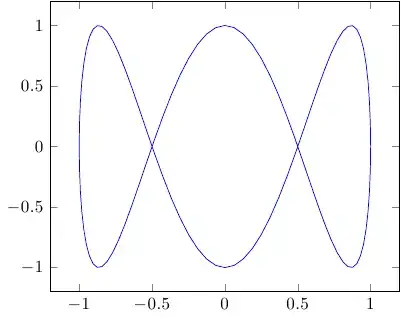

In R it's easy to do something like
x <- seq(0, 2*pi, 0.01)
plot(sin(x), cos(3*x), type='line')
to get the plot
How can I make such a plot using tikz/pgfplots?

It is also easy with pgfplots
\documentclass{standalone}
\usepackage{pgfplots}
\pgfplotsset{compat=1.12}
\begin{document}
\begin{tikzpicture}
\begin{axis}
\addplot+[domain=0:360,samples=101,no marks] ({sin(x)},{cos(3*x)});
\end{axis}
\end{tikzpicture}
\end{document}

  • I'd say: easier and prettier. – Sigur Aug 22 '15 at 15:09
    +1 . Since this is an answer to a beginner question, I would like to advertise that \pgfplotsset{trig format plots=rad} in the preamble would reconfigure all plots to use radians. In this case, one could also write domain=0:2*pi to get the same outcome. – Christian Feuersänger Aug 22 '15 at 15:13
