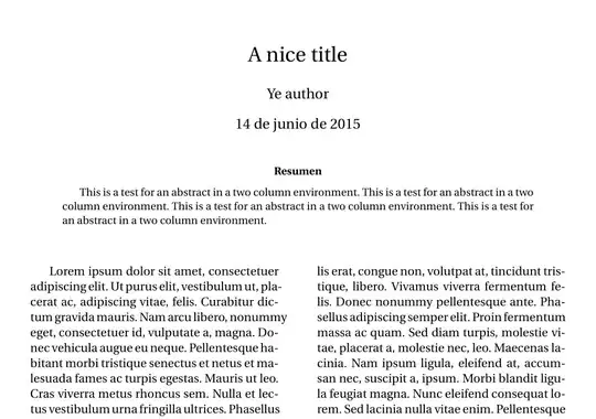

If you want to consider using the twocolumn option of the documentclass, you can use either the @twocolumnfalse environment, or the strip environment, from the cuted package (sttools bundle).
@twocolumnfalse environment:
\documentclass[a4paper, twoside, spanish]{article}%
\usepackage[utf8]{inputenc}
\usepackage[T1]{fontenc}
\usepackage{babel}
\usepackage{geometry}
\usepackage{fourier, erewhon}
\usepackage{lipsum}
\title{A nice title}
\author{Ye author}
\date{\today}
\setlength\columnsep{3em}
\begin{document}
\twocolumn[%
  \begin{@twocolumnfalse}
    \maketitle
    \begin{abstract}
      This is a test for an abstract in a two column environment. This is a test for an abstract in a two column environment. This is a test for an abstract in a two column environment. This is a test for an abstract in a two column environment.
    \end{abstract}
    \vskip2\baselineskip
  \end{@twocolumnfalse}
  \lipsum[1-6]
\end{document}
strip environment: \documentclass[a4paper, twocolumn, twoside, spanish]{article}% \usepackage[utf8]{inputenc} \usepackage[T1]{fontenc} \usepackage{babel} \usepackage{geometry} \usepackage{fourier, cuted, erewhon} \usepackage{lipsum} \title{A nice title} \author{Ye author} \date{\today} \setlength\columnsep{3em}
\begin{document}
\begin{strip}
  \vspace*{\dimexpr-\baselineskip-\stripsep\relax}
  \centering
  \maketitle
  \begin{abstract}
    \begin{minipage}{0.9\linewidth}
      This is a test for an abstract in two column mode. This is a test for an abstract in two column mode. This is a test for an abstract in two column mode. This is a test for an abstract in two column mode. This is a test for an abstract in two column mode.
    \end{minipage}
  \end{abstract}
\end{strip}
\lipsum[1-6]
\end{document}
