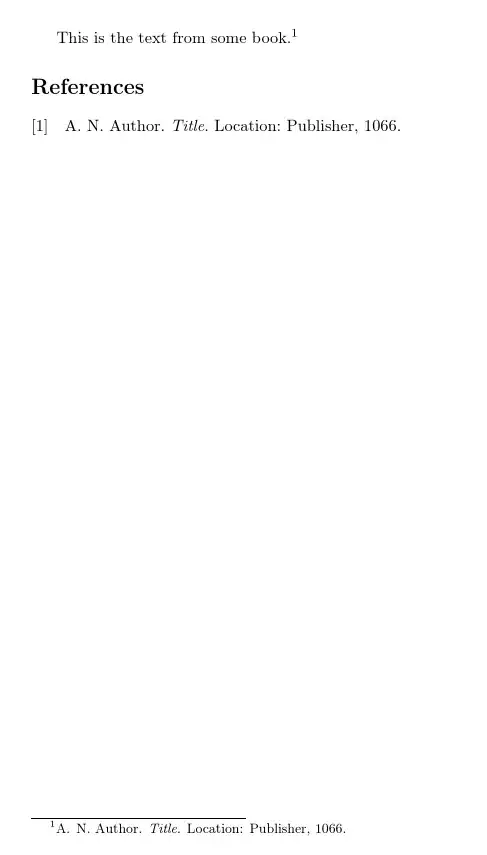

This is the text from some book. \footfullcite{lit1}
\printbibliography
\end{document}

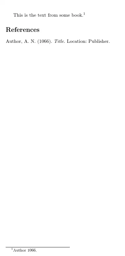

biblatex with full citation in footnote
This is just for purposes of demonstration: you wouldn't normally want a full citation in the footnote and a separate bibliography. Although I have seen undergraduate submission requirements which actually demanded just this.
Another way, As Andrew Swann suggested is to use
\usepackage[backend=biber,style=authoryear]{biblatex}
with the \footcite{lit1} which would give
author-year
Or you can use \footfullcite{} and simply remove the \printbibliography command if you don't need a separate bibliography.
