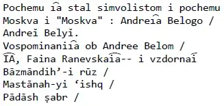

  • Consolas has all the characters in your MWE and has good diacritic handling: enter image description here
  • Liberation Mono, Unifont, and Courier New have all the characters in your MWE. However, they don't handle the positioning of the combining tie bar (U+0361) or the left/right combining tie bar characters (U+FE20 and U+FE21) well.

Pochemu i͡a stal simvolistom i pochemu
Moskva i "Moskva" : Andrei͡a Belogo /
Andreĭ Belyĭ.
Vospominanii͡a ob Andree Belom /
I︠A︡, Faina Ranevskai︠a︡-- i vzdornai︠
Bāzmāndihʼ-i rūz /
Mastānah-yi ʻishq /

  • Jason, I copied windows Consolas font to linux font folder, and ran again as you showed. Viola! at least I did not get font errors, but those Russian characters show a little differently. The 2 top lines of my example shows as some of the characters overlapping. I copied and pasted here. 'Pochemu aı͡ stal simvolistom i pochemu' 'Moskva i "Moskva" : Andreaı͡ Belogo'. But this is not exactly how it shows in pdf. I wish I could show screen print of the characters here. Another thing is the column after title are all messed up. Is this because monofont is not correctly written in pdf? Thank you – Jason Min Feb 04 '15 at 22:05
