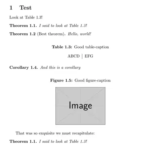

Output:

To have the same numbering for tables and figures, add the following lines in your preamble:
\makeatletter
\let\c@figure\c@table
\makeatother
Also, if you don't want to use \numberwithin many times, you can proceed in this way. First of all, declare
\numberwithin{table}{section}
\numberwithin{figure}{section}
and then declare your theorem-like environment as follows:
\declaretheorem[numberlike=table]{theorem}
\declaretheorem[numberlike=theorem]{corollary}
Complete MWE:

Output
