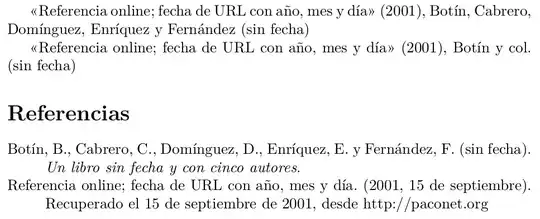

Long dates for Spanish are not implemented in biblatex-apa [Update: now they are; see below]. The following example modifies the appropriate definitions first appearing in spanish-apa.lbx to workaround a bug in the package which made the nodate label to appear instead of the actual localised string. It makes the Oxford comma to go away, the ampersand to be translated, the nodate appear as "sin fecha" and long dates to appear correctly in citations and references. It cites works twice to show the et al feature.

result of the above example showing workaround to buggy biblatex-apa
