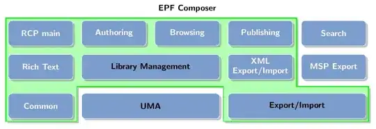

My goal is to draw a complex system architecture.
Some approaches to do it are here How to draw a layered architecture using Latex?
This approach https://tex.stackexchange.com/a/102669/44348 seems to be very interesting, so one can make following modifications in that example:
  1. Add shadow options \usetikzlibrary{shadows}
  2. Add a way to cut shadows from a node, please, see here remove drop shadow from one node
  3. Make nodes in empty cells=false
  4. Add |[no shadows]| to the cell that is going to be merged just to make a shape, anchor and name of this cell and prevent a mistake e.c.t.
I've some problems with:
  1. Adding the pictures, like database Display Database Instance Relationship with TikZ, for example
    in the cells (stack-5-6) (stack-6-6) with the name to make an arrow in future.
  2. Creating an arbitrary block of nodes with the border and shadow, for example
    • we don't have a border and shadow near the cell (stack-3-4),
    • we can't set a color of the matrix' body, because it'will be over the blocks with background.
    A way of adding pictures is described here Nodes and matrix of nodes but I can't adopt it well.
    A way of creating blocks as backround layers is described here http://www.texample.net/tikz/examples/kalman-filter/ but I can't have right borders and shadows. There is a problem to use fit option of background to get a good solution.

The output AS-IS: AS_IS
The output TO-BE: enter image description here
Is this what you want?
Problem 1: Adding the pictures, like database Display Database Instance Relationship with TikZ, for example in the cells (stack-5-6) (stack-6-6) with the name to make an arrow in future.

Update: Making holes
I understand from your comment that your intention is to make holes in your scheme to represent that some blocks are not part from a set. From my point of view, it's difficult to draw arbitrary holes and respect shadowing. I could manage to draw an internal shadow for a rectangular hole and I hope something similar could be applied to arbitrary holes but I think this should be another question.
What I've done has been to apply Paul Gaborit's shadowed style adapted to default shadow style (first lines from section 66.3.1 Drop Shadows in pgfmanual.pdf).
shadowed/.style={postaction={draw=black!50, opacity=.5, line width=.5ex}}
and use this style to draw an internal shadow to certain rectangular node:
\begin{pgfonlayer}{background}
\coordinate (aux) at ([xshift=2mm]stack-4-5.east);
\node [background, fit=(stack-2-1) (stack-4-1) (aux),
       draw, drop shadow] {};
%draw a white `background` around node
\node [fill=white, fit=(stack-3-5)] (hole) {};
%draw an internal shadow
\begin{scope}
    \clip (hole.south west) rectangle (hole.north east);
    \path[shadowed] (hole.south west) |- (hole.north east);
\end{scope}
\end{pgfonlayer}
The result looks like:
** 2nd Update: Non rectangular background
You don't need to use rectangular backgrounds because a drop shadow can be also applied to any closed path. The difficult part is how to define the complex background. Next code show an example. I've still used the rectangular (although not drawn neither filled) background as reference to compoun a complex closed shape. Just changed code is provided:
        \node [
            fit=(stack-2-1) (stack-4-5),
        ] (BigGroup) {};
        \draw[green, fill=green!30, very thick, drop shadow] (BigGroup.north west) -| ([shift={(-2mm,-3mm)}]stack-3-5.south west) -| (BigGroup.south east) -| ([shift={(-2mm,3mm)}]ExImp.north west)-|([xshift=-2mm]UMA.west|-BigGroup.south)-|cycle;
    \end{pgfonlayer}
The result is: enter image description here
Ignasi
  • 136,588
  • thank you very much. Perhaps, I didn't explain clear an idea about MSF-Export. It'll be very useful to have a tool to exclude some nodes (cells) from the block made with background, for example, please see here. "Kernel" block is excluded from "Services", which has not-rectangle-like shape, surrounded with border and shadow. My code with "wrong white clolor" was an attempt to exclude MSF-Export from the background block. The next step might be drawing missing lines and shadows in the backgound block or to try another designing way... – Vladimir Parkhomenko Aug 26 '14 at 10:58
  • @VladimirParkhomenko: I've updated the answer. Is this what you mean? – Ignasi Aug 26 '14 at 11:58
  • yes that is what I mean. Do you have an idea how to control the shifting of the hole in each particular direction (east, west, north, south)? For example it would be great to cut the part of the backround block, which is close to (MSP Export.east). – Vladimir Parkhomenko Aug 26 '14 at 14:30
  • @VladimirParkhomenko: \path[shadowed] (hole.north west) -- (hole.north east);? I'm not sure to understand you. – Ignasi Aug 26 '14 at 17:03
  • One possible way is to create two new points \coordinate (myAux) at ([xshift=2mm]stack-3-5.east);and \coordinate (myAuxX) at ([yshift=4mm]stack-2-5.north); and modify hole: \node [fill=white, fit=(stack-2-5)(stack-3-5)(myAux)(myAuxX)] (hole) {};. However in this case we have to guess what yshift, xshiftto choose. – Vladimir Parkhomenko Aug 26 '14 at 18:07
  • @VladimirParkhomenko I've made a second update. – Ignasi Aug 27 '14 at 07:55
  • The perfect answer! – Vladimir Parkhomenko Aug 27 '14 at 09:38
