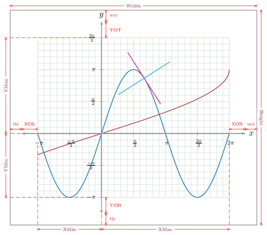

An easy-to-customize template with PSTricks.
\documentclass[pstricks,border=0pt,12pt,dvipsnames]{standalone}
\usepackage{amsmath}
\usepackage{pstricks-add}
\usepackage{pst-plot}
% \usepackage{pst-math} provides ATAN
\usepackage[nomessages]{fp}
\FPeval\XMin{0-2*pi}
\FPeval\XMax{2*pi}
\FPeval\YMin{0-pi}
\FPeval\YMax{5*pi/3}
\FPeval\XOL{0-1/3} % of DeltaX
\FPeval\XOR{1/3} % of DeltaX
\FPeval\YOB{0-1/3} % of DeltaY
\FPeval\YOT{1/3} % of DeltaY
\FPset\TrigLabelBase{3}
\FPeval\DeltaX{pi/TrigLabelBase}
\FPeval\DeltaY{pi/TrigLabelBase}
\FPeval\AxisL{XMin+DeltaX*XOL}
\FPeval\AxisR{XMax+DeltaX*XOR}
\FPeval\AxisB{YMin+DeltaY*YOB}
\FPeval\AxisT{YMax+DeltaY*YOT}
\newlength\Width\Width=12cm
\newlength\Height\Height=8cm
\newlength\llx\llx=-5pt
\newlength\urx\urx=15pt
\newlength\lly\lly=-5pt
\newlength\ury\ury=15pt
\psset
    llx=\llx,
    lly=\lly,
    urx=\urx,
    ury=\ury,
    xtrigLabels=true,
    ytrigLabels=true,
    trigLabelBase=\TrigLabelBase,
    labelFontSize=\scriptstyle,
    xAxisLabel=$x$,
    yAxisLabel=$y$,
    algebraic,
    plotpoints=500,
\def\f{Pi*sin(x)}
\def\fp{Derive(1,\f)}
\def\g{2*asin(x/(2*Pi))}
\begin{document}
\pslegend[lt]{%
    \color{NavyBlue}\rule{12pt}{1pt} & \color{NavyBlue} $y=\pi\sin x$ \\
    \color{Red}\rule{12pt}{1pt} & \color{Red} $y=\pi\cos x$ \\
    \color{ForestGreen}\rule{12pt}{1pt} & \color{ForestGreen} $y=2\sin^{-1}\left(\tfrac{x}{2\pi}\right)$
\begin{psgraph}
        dx=\DeltaX,
        dy=\DeltaY,
        linecolor=gray,
        tickcolor=gray,
        ticksize=-3pt 3pt,
        axespos=top,
    ]{<->}(0,0)(\AxisL,\AxisB)(\AxisR,\AxisT){\dimexpr\Width-\urx+\llx}{!}%{\dimexpr\Height-\ury+\lly}
    \psaxes
        dx=\DeltaX,
        dy=\DeltaY,
        labels=none,
        subticks=5,
        tickwidth=.4pt,
        subtickwidth=.2pt,
        tickcolor=Red!30,
        subtickcolor=ForestGreen!30,
        xticksize=\YMin\space \YMax,
        yticksize=\XMin\space \XMax,
        subticksize=1,
    ](0,0)(\XMin,\YMin)(\XMax,\YMax)
    \psplot[linecolor=NavyBlue]{\XMin}{\XMax}{\f}
    \psplot[linecolor=Red]{\XMin}{\XMax}{\fp}
    \psplot[linecolor=ForestGreen]{\XMin}{\XMax}{\g}
    % tangent and normal
    \psplotTangent[linecolor=Magenta]{Pi 3 div 2 mul}{1.5}{\f}
    \psplotTangent[linecolor=Cyan,Derive={-1/\fp}]{Pi 3 div 2 mul}{1.5}{\f}
    % sum
    \psplot[linecolor=Rhodamine]{\XMin}{\XMax}{Sum(i,0,1,7,(-1)^(i)*x^(2*i)/fact(2*i))}
\end{psgraph}
\end{document}
Documentation
This section explains the settings used in the template.
