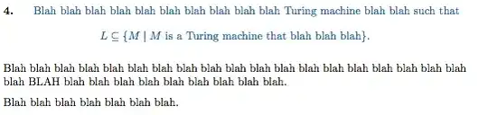

EDIT #2: It's a very minor difference, but I'm seeing a larger gap between the math and the text than between the text and the text:
Here's the relevant code:
\textbf{4.} \hspace{5 pt}
\begin{specialmathtwo}
Blah blah blah blah blah blah blah blah blah blah Turing machine blah blah such that
\[L \subseteq \{ M \mid \text{$M$ is a Turing machine that blah blah blah} \}.\]
\end{specialmathtwo}
Blah blah blah blah blah blah blah blah blah blah blah blah blah blah blah blah blah blah blah blah BLAH blah blah blah blah blah blah blah blah blah.
Blah blah blah blah blah blah blah.
and
