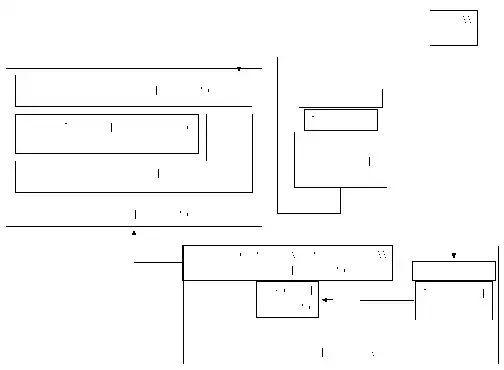

I have seen How to allow labels' anchors in TikZ to be affected by rotations without rotating the text itself?; but that question doesn't seem to answer my problem, so here it goes.
With the MWE below, I get this as the node diagram that I want:
If I uncomment rotate=180 and anchor=center, I get this below - it is good the text in labels is not rotated, as I want it, but the composition is otherwise a mess:
Finally, if I also enable/uncomment the transform shape - the composition is better for some elements, worse for others, but now also text in labels is rotated, which I don't want:
So the question is - is there a way to rotate the whole composition correctly, AND not have the text in nodes rotated? My desired output, faked in GIMP:

sdaau
  • 17,079
    This is tough because your nodes are defined in different manners and with different anchors. One thing that works is replace each {Node label} with {\rotatebox{180}{Node label}} and then rotate the whole document. However, since some labels span more than one line, you would then have to reverse the order of those lines, and apply \rotatebox to each line. It's such a case-specific solution I don't think it's a solution at all, but I'm pretty sure it will work. – Jānis Lazovskis Mar 27 '14 at 03:49
  • Many thanks for the comment, @JānisL - I was hoping there was a way to "interrupt" the pgf transformations just for the text (or alternatively, reapply transformations only to text), but I wasn't aware of those complications - good to have them in mind. Cheers! – sdaau Mar 27 '14 at 05:48
Ok, here is a fix - for a halfway fix, using the add reference and fitting nodeR styles (as per Connecting line calculations with fitting node in 3D tikz?), seems to fix the layout of nodes with rotate and transform shape - I'd just need help now on having the text not rotated in that case (see below); here is the image:
Then, thanks to #168052 Referencing the contents of lasttikznode, and overlaying them on a node, I've found that it is possible to implement a node style, where the turn environment from the rotating package can be used to rotate the node content box only, implemented as a separate style rotnt; then the drc node style can simply inherit it - and the only inline change in the nodes' code, would be to style unstyled nodes with rotnt, so they also get rotated. And finally, I obtain the desired image:
