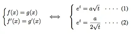

I want a equation like this
Code is below
But now I can't number equations like the above as without using \cdot and (1) etc. manually. I'm so confused. Please help. Thank you.
\begin{equation*}
 \left\{\,
  \begin{IEEEeqnarraybox}[
     \IEEEeqnarraystrutmode
     \IEEEeqnarraystrutsizeadd{2pt}
      {2pt}
    ][c]{rCl}
f(t) & = & g(t)\\
f'(t)&=&g'(t) \end{IEEEeqnarraybox} \right. \quad
\Longleftrightarrow \quad \left\{\,
     \IEEEeqnarraystrutsizeadd{7pt}
      {7pt}
    ][c]{rCl}
   e^t & = & a\sqrt{t}\qquad\cdots (1)
   e^t & = & \frac{a}{2\sqrt{t}}\qquad\cdots (2)
 \right.
 \label{eq:example_left_right2}
\end{equation*}

Well, I'll start by saying that I could not easily figure a way to finagle ieeeeqnarraybox to do this [not that it couldn't be done with enough effort]. However, you can achieve nearly the same result with the amsmath and cases packages.
\documentclass[]{IEEEtran}
\usepackage{amsmath,cases}
\begin{document}
\begin{numcases}{
\begin{cases}
f(x) = g(x) \\
f'(x) = g'(x)
\end{cases}
e^t = a\sqrt{t}  \vphantom{\frac{a}{2\sqrt{t}}} \\
               % \vphantom used to keep space in each case equal
e^t =  \frac{a}{2\sqrt{t}}
\end{numcases}
\end{document}
This gives a nice looking:
eq no leader
You can optionally call \usepackage[subnums]{cases} to enable sub-equation numbering, where each case would be labeled (1a) and (1b), respectively.
While I could not get the spacing to work automatically (inspired by @DavidCarlisle from here) due to the complexity of the expression, you can add a couple lines to automatically create leader lines as shown below. I think that with the nature of how this code works, it will end up being more hassle than it is worth to tweak the leader lines, but it can be done if that is the look you truly desire. Personally, I would go with the first solution and omit the leader lines.
