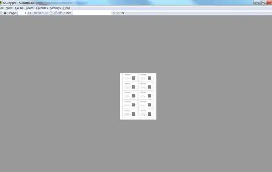

I just show the output with a zoom out to show you that it's working (5x2 cards on a4 page)
