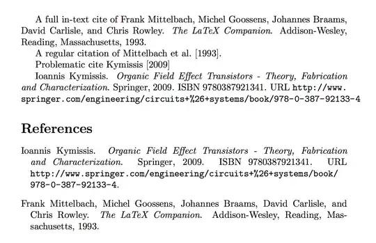

In few of my citations I have a % sign in the url, which gives a problem when I use the bibentry environment (Paragraph ended before \BR@c@bibitem was complete). How can I deal with the % sign? Without the reference containing the % in the url everything works fine. Also without using the bibentry the % gives no problem. the % sign gives also no problem using a different bibliography stile as unsrt, which is not using the url information (which I don't want to do). (The bibliography style statto can be found here, same problem occurs using plainnat). Not using \begin{NoHyper}\bibentry{goossens93}\end{NoHyper} would be preferred to hyperlink the reference to the website, but I don't know if this would be possible at all.

This seems to work: the \BR@c@bibitem macro is patched to change the category code of % before grabbing its argument.

A full in-text cite of
\begin{NoHyper}\bibentry{goossens93}\end{NoHyper}.
A regular citation of \cite{goossens93}.
Problematic cite \cite{Kymissis__2009}
\begin{NoHyper}\bibentry{Kymissis__2009}\end{NoHyper}
\bibliographystyle{plainnat}
\bibliography{mytestbib}
\end{document}
Some words about the trick.
The bibentry package redefines \bibitem to use the internal macro \BR@c@bibitem which basically grabs the argument of \bibitem and then all that comes up to the first blank line as its second argument. The presence of % in the argument of \url confuses the parser which is unable to see the closing brace, which is behind the %.
Thus we redefine the macro to do the work in two stages:
  1. it opens a group;
  2. inside this group it sets the category code of % to 12, making it a printable character;
  3. calls \ORIG@BR@c@bibitem
The final macro is basically a copy of the original \BR@c@bibitem, with the only change that at the end of its work it issues the \endgroup that balances the \begingroup issued by (the new) \BR@c@bibitem.
