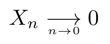

I want to write this:
I tried with $x_n \to_{n \to 0} 0$ but the $n \to 0$ doesn't go under the right arrow, it goes under but on the right, and I want it under but in the center, as in the picture above.
jub0bs
  • 58,916
5 Answers5
34
You can also use the function \xrightarrow:
$ x_n \xrightarrow[n \to 0]{} 0$
Result
The user's guide of the amsmath package says :
\xleftarrow and \xrightarrow produce arrows that extend automatically to accommodate unusually wide subscripts or superscripts. These commands take one optional argument (the subscript) and one mandatory argument (the superscript, possibly empty)"

You can use the function of \underset and \overset, in this case an arrow is simply defined with:
\underset{n\to 0}{\longrightarrow}
Which points the expression related to "n" under the second argument, here there are two versions depending on the size of the underset (using \scriptscriptstyle):
\documentclass{article}
\usepackage{amsmath}
\begin{document}
X_n\underset{n\to 0}{\longrightarrow}0 \qquad%
X_n\underset{\scriptscriptstyle{n\to 0}}{\longrightarrow}0
\end{document}
Which yields:
