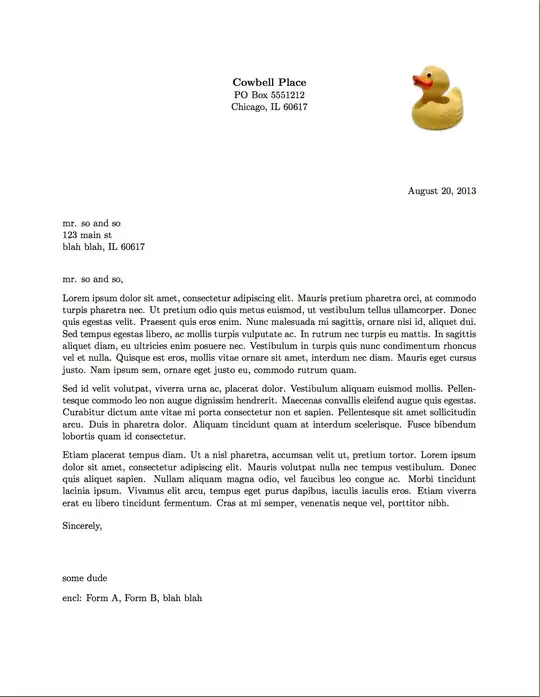

I would like to add a logo to the top right of the document in line with the centered address on the top. I found Put an image header in \documentclass{letter} but this adds a line and separates itself from my centered top address. Here is a MWE:

I'd like it to go here:
example of logo placement and alignment

Here's a way: you can make the header in a box, where you can play with alignment. The main trick is to set the logo flush right without influencing the centering of the main header, which is done by setting the logo in a zero width box.
The \raisebox is to align the logo vertically.
Rather than setting parameters by hand, it's better to use geometry; also \bf should not be used; note also that \large is not a command with an argument, but a declaration similar to (the deprecated) \bf.
