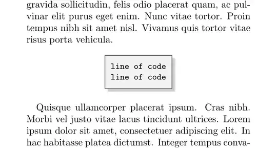

I'm trying to define a environment for code listings wrapped in a shadowbox and centered in the line. Using this code, I can generate the kind of output that I want:
\documentclass[twocolumn]{article}
\usepackage{listings}
\usepackage{fancybox}
\usepackage{lipsum}
\begin{document}
\lipsum[4]
\begin{center}
  \shadowbox{%
    \begin{lstlisting}[gobble=6]
      line of code
      line of code
    \end{lstlisting}%
\end{center}
\lipsum[4]
\end{document}
This produces output like this:
code listing in a shadowbox in a center environment
My problem arises when trying to abstract this into an environment. I've seen the some related questions:

Here is a proposal using tcolorbox. Colors, shadows, etc. can be adjusted to your liking. You may replace style=tcblatex by any listings setting you want to have as default for your environment.
\usepackage{lipsum}
\usepackage[most]{tcolorbox}
\newenvironment{CenteredShadowboxListing}[1][]{%
  \tcbset{listing options={style=tcblatex,#1}}\tcbwritetemp}%
  {\endtcbwritetemp%
  \tcbox[enhanced,arc=0pt,outer arc=0pt,top=1mm,bottom=1mm,left=1mm,right=1mm,
  boxrule=0.6pt,drop fuzzy shadow,before=\begin{center},after=\end{center}]%
  {\tcbusetemplisting}}
\begin{document}
\lipsum[4]
\begin{CenteredShadowboxListing}
line of code
line of code
\end{CenteredShadowboxListing}
\lipsum[4]
\end{document}
UPDATE: With tcolorbox version 2.41 of 2013/07/23, the code to typset the example above can be written more compact with the same result:
\usepackage{lipsum}
\usepackage[most]{tcolorbox}% version 2.41 or newer
\newtcblisting{CenteredShadowboxListing}[1][]{%
  listing options={style=tcblatex,#1},hbox,listing only,
  boxrule=0.6pt,drop fuzzy shadow,before=\begin{center},after=\end{center}}
\begin{document}
\lipsum[4]
line of code
line of code
\lipsum[4]
\end{document}
  • This is very nice. I haven't used tcolorbox before, so it's a nice addition to the toolbox. It seems similar to fancybox's Sbox/TheSbox, and to adjustbox that works with a bgroup/egroup pair. The answer stands on its own and doesn't really need to be updated, but do you have any reference for why tcolorbox's box can hold a listing while the other package's boxes fail? – Joshua Taylor Jul 18 '13 at 20:29
  • Actually, while I like the look of the result, I'm having both some trouble understanding it, and getting it to work. What version of tcolorbox are you using? I'm using the version from TeXLive 2012, and most is an unknown option for tcolorbox. If I remove the most option, then I get the error that ! Undefined control sequence. <argument> \tcbusetemplisting. Finally, I don't see where in the code you provided that the listings package is getting used. Is the code you posted a complete working example? – Joshua Taylor Jul 18 '13 at 20:46
  • The tcolorbox manual explains that \tcbusetemplisting sets the content written to the temporary file tcbwritetemp as a listing. To use this, the example also needs \tcbuselibrary{listings}. The manual also shows that most is a library shorthand for loading all the libraries except documentation. Even so, when I remove the most package option and instead to \tcbuselibrary{most}, I get the error "Package pgfkeys Error: I do not know the key '/tcb/library/most' and I am going to ignore it." – Joshua Taylor Jul 18 '13 at 21:06
  • Of course, reading through the manual and poking in the source, I see that you're the author, so you probably know all this, some of these comments are for anyone else who comes along and finds this answer. Is the trick just that I need a later version of tcolorbox? – Joshua Taylor Jul 18 '13 at 21:06
  • @JoshuaTaylor: Sun is rising up in Europe and I see that you were busy while I was asleep ;-) First of all, the given proposal is a complete working example. But you need a recent version of tcolorbox; at least v2.31. The current one is v2.40 which I recommend, see How do I update my TeX distribution?. Updating will remove all problems. – Thomas F. Sturm Jul 19 '13 at 06:09
  • @JoshuaTaylor On the technical side, my solution writes the content of the box into a temporary file. This file is loaded again using internally \lstinputlisting. You could use this trick also in combination with the other boxing packages. Nevertheless, tcolorbox has a special support for using listings which makes the code compact. – Thomas F. Sturm Jul 19 '13 at 06:16
  • @JoshuaTaylor I've edited the code because the passing of the environment option was without effect in the old code. You may replace style=tcblatex by any listings setting you want to have as default for your environment. Note that gobble will not work because of using \lstinputlisting (restriction coming from listings). – Thomas F. Sturm Jul 19 '13 at 07:16
  • After updating TeXLive to the 2013 version, this works like a charm. My colleagues will probably be unhappy with me if they have to run the very long install, but that would be another question I suppose (What do I do about colleagues who hate downloading big TeXLive installations?). Thanks for the very nice looking answer! – Joshua Taylor Jul 19 '13 at 16:14
