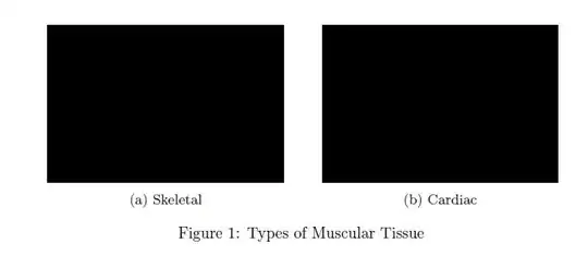

This seems to work just fine for me:
\documentclass{article}
\usepackage[T1]{fontenc}
\usepackage[utf8]{inputenc}
\usepackage{subfloat}
\usepackage{subcaption}
\usepackage{caption}
\usepackage[demo]{graphicx}
\begin{document}
\begin{figure}
    \begin{subfigure}[b]{.5\linewidth}
        \centering
            \includegraphics[scale=1]{demo}
            \caption{Skeletal}
        \label{fig:SkeletalTissue}
    \end{subfigure}
        \centering
            \caption{Cardiac}
        \label{fig:CardiacTissue}
    \end{subfigure}
    \caption{Types of Muscular Tissue}
    \label{fig:MuscularTissue}
\end{figure}
\end{document}
This is the result. Is this what you were looking for?enter image description here

  • I copied ur script and added my figure file in it. But i still got the same result. I have added link of the result i have recieved..... http://tinypic.com/r/2v1wvo1/5 – user2467143 Jun 09 '13 at 16:20
    Dear @user2467143, your captions are centered, but are centered to the whole figure. This means the part of the axis where "amplitude m/s^2" is written is also part of the graphic. For tweaking your captions you can add \hspace*{5mm}\caption{Your caption}. 5mm have been selected arbitrary, but you can choose as much space as you see fit. – Mario S. E. Jun 09 '13 at 16:53
