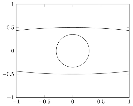

How can I draw on an axis from pgfplots? I already found out, that I somehow have to use axis cs: in front of the coordinates (what does cs mean?), but the following example does not draw the ellipse:
\begin{tikzpicture}
  \begin{axis}
    \draw (axis cs:0,0) ellipse (1cm,1cm);
  \end{axis}
\end{tikzpicture}
What am I doing wrong? What's the general way of drawing on an axis plot?

Let’s break it down:
The “older syntax” for the ellipse path operator is ellipse (<x radius> and <y radius>).
But, there is a newer and better syntax. I agree here with the manual:
Note: There also exists an older syntax for circles [and ellipses], where the radius of the circle is given in parentheses right after the circle command as in circle (1pt). Although this syntax is a bit more succinct, it is harder to understand for readers of the code and the use of parentheses for something other than a coordinate is ill-chosen.
  — PGF manual, section 14.7 “The circle and Ellipse Operations”, p. 148
The following syntax is much more readable:
\draw (axis cs:0,0) ellipse [x radius=1cm, y radius=1cm];
and you could also add scale and rotate options or can use them in the every circle style or …
But still, no output of an ellipse. :(
Reading section 4.16 “Custom Annotations”, pp. 263ff of the pgfplots manual we can find a few examples using the ellipse path operator, where axes limits are always given. These are needed if the axis environment does not contain one single plot.
So, this works:
\begin{axis}%[xmin=-1,xmax=1,ymin=-1,ymax=1]
  \addplot {x^2 - x + 4};
\end{axis}
This does not:
\end{axis}
But this:
\begin{axis}[xmin=-1,xmax=1,ymin=-1,ymax=1]
\end{axis}
You can also use radii given in pgfplots direction vectors, these automatically use the axis direction cs (cs stands for Coordinate System, which itself has a big chapter in the PGF manual). To do this you will need to set at least compat=1.5.1.
Simply omit the dimension units and pgfplots automatically assumes the axis direction cs:
\draw (axis cs:0,0) ellipse [x radius=2,  y radius=.5];
Code
\documentclass[tikz]{standalone}
\usepackage{pgfplots}
\pgfplotsset{compat=1.7}
\begin{document}
\begin{tikzpicture}
%    \addplot {x^2 - x +4};
  \end{axis}
\end{tikzpicture}
\end{document}
