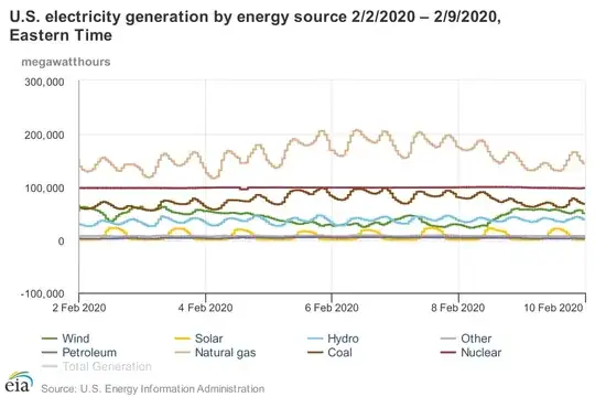

You can see this in the hourly generation data from the U.S. Energy Information Agency:
U.S. electricity generation by energy source, 2/2/2020 to 2/9/2020
Nuclear is a flat line, natural gas swings wildly with two peaks a day, and coal strikes a balance between the two.
As a result, electrical systems need other power sources besides nuclear to meet fluctuating power demand -- even when nuclear is operating at 100%, the system is designed such that other sources will be required to meet all demand.
