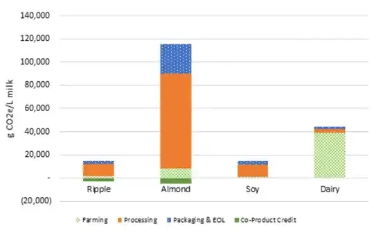

Ripple Foods, the California-based producers of non-dairy milks made from pea protein, commissioned a Life Cycle Analysis of different milk products that included both soy milk and cow/dairy milk.
They concluded that soy milk has a smaller carbon footprint than dairy milk.
Source: https://www.ripplefoods.com/pdf/Ripple_LCA_Report.pdf
