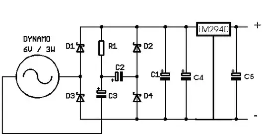

Read my answer here on Electrical Engineering Stack Exchange Building a new dynamo bike light. From there you will find an indirect link to this PDA / GPS bike mounted USB charger. This doubles the voltage from the hub dyno to allow low speed operation. His circuit (shown below) may be somewhat daunting if you have never built such but he discusses what is involved and you can get advice on the Electrical Engineering SE page if you decide to pursue this. Cost of this is probably a few GBP - if you pursue this people on the EE site (including me) would be happy to comment on what is needed for battery charging.
