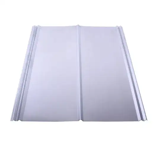

On the subject of profiles, the profile of that Fabral panel has large amounts of flat surface. Flat surfaces tend to accumulate clumps of debris (e.g. dust/dirt/pollen/leaves) because water always takes the path of least resistance and tends to flow around obstructions rather than trying to push through them. Thus if your area has long periods of no rainfall, debris will build up and the first (usually light) rains will not wash off the debris. The intensity/duration of the rainfall needs to increase before flat surface debris is dislodged — and by that time your first flush diverter is already full and the clumps of debris go straight into your tank > tap > you.
Corrugated profiles are half valley, half ridge. Debris naturally ends up in the valleys and, because that's where all the water is forced to go, is pushed downstream immediately — even in light rains. Corrugated profiles are thus the best profile to have if you want to have a 'self-cleaning' roof.
Corrugated profiles complement first-flush diverters. Flat profiles undermine first-flush diverters.

As I've researched, I've found Home Depot sells these panels: Fabral 26 in. x 8 ft. Galvanized Steel 5V Crimp Roof Panel Galvanized Roofing
These panels will cost about $18 after taxes and cover 24 sq ft, at about $0.75/sq ft. So I think that my solution will be to use these panels (or another panel variety coated with Galvalume or Kydar), but not the wavy corrugated stuff, simply because it's difficult to walk on.
