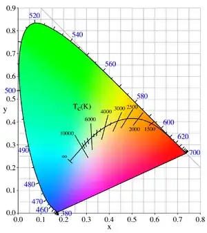

CCT and colour :
From Wikipedia - color temperature
Anywhere on the black curved line (The "Plankian locus") is seen by the eye as white !!!
CCTs are shown on the curved line. Daylight at midday is about central and tungsten is towards the yukky orange end :-).
