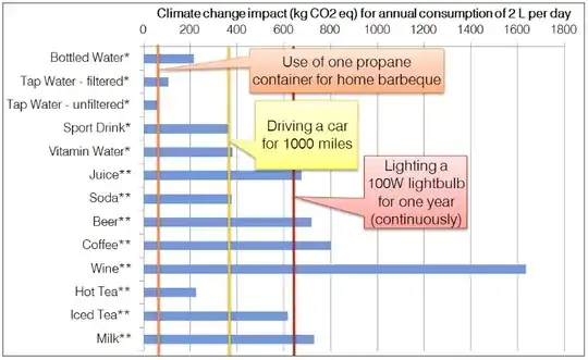

TL;DR -- The best option, per liter, is tea. Soda is about twice as "bad," and coffee is two times worse than that.
To compare the environmental impact of various beverages we need to perform a life-cycle assessment. From Wikipedia:
Life-cycle assessment (LCA, also known as life-cycle analysis, ecobalance, and cradle-to-grave analysis) is a technique to assess environmental impacts associated with all the stages of a product's life from raw material extraction through materials processing, manufacture, distribution, use, repair and maintenance, and disposal or recycling.
In 2010, Nestle Waters North America commissioned a study to look at the environmental impact of various beverage choices. They hired Quantis to do this study. According to their website, Quantis
[...] guide[s] top organizations to define, shape and implement intelligent environmental sustainability solutions [...] We are [...] sustainability’s scientists, experts, strategists, innovators and visionaries.
The study is titled "Environmental Life Cycle Assessment of Drinking Water Alternatives and Consumer Beverage Consumption in North America", and looked at 13 popular beverages in North America, including coffee, tea, and soda. The report includes new research as well as reviews of existing studies, and provides the following chart:

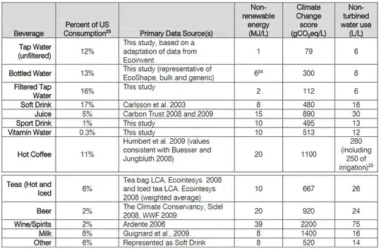

A table showing the values per liter (and references) is provided later in the report:
Unfortunately, this table shows the weighted average of hot tea and iced tea. From the chart though it's clear that hot tea has a much lower overall carbon footprint.
Conclusion: hot tea is the most sustainable pick-me-up. A can of coke is about twice as bad, and a cup of coffee is about four times worse.
