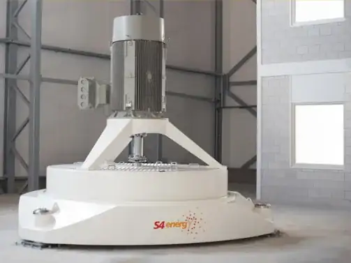

Not quite domestic, but the technology keeps maturing.
It's better suited for leveling short-lived and massive power needs rather than storing energy for days (note the 7%/hr loss below).
Each Kinext unit includes a flywheel with a mass of 5,000 kg and a large diameter (around 2.6 meters). The companies said it is able to spin relatively slowly, at 1,800 rpm, but it can reach a maximum speed of around 950 km per hour.
Source: https://www.pv-magazine.com/2022/10/04/abb-to-stabilize-dutch-grid-with-9-mwh-battery-flywheel-storage-facility/
Diameter quoted from: https://new.abb.com/news/detail/93092/regenerative-drives-and-motors-unlock-the-power-of-flywheel-energy-storage-to-stabilize-europes-grids
More data from: https://www.s4-energy.com/includes/PDF/Flyer_KINEXT.pdf
Technology Flywheel
Capacity 30 kWh
Stand-By Loss 7 %/hr
Power Capacity Modular, 0,1 – 1 MW
Cycle Efficiency 92 %
Response Time < 20 ms
Lifetime 20 years/1.000.000+ cycles
Footprint 4 x 4 meters
2.6m diameter, 5 ton flywheel with footprint of 4x4m, bolted to concrete floor
In addition to the Kinext solution described below, ABB is advertising flywheel solutions for ships, tugs etc. which need little energy most of the day (and can charge the flywheel) but need massive bursts of energy for minutes at a time (and today they carry 5x the number of diesel generators just for those bursts):
