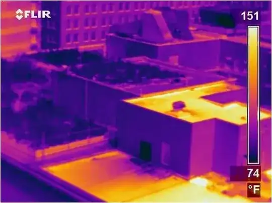

Chicago compared summertime surface temperatures on a green roof with a neighboring building. On an August day in the early afternoon, with temperatures in the 90s, the green roof surface temperature ranged from 91 to 119°F (33 to 48°C), while the dark, conventional roof of the adjacent building was 169°F (76°C). The near-surface air temperature above the green roof was about 7°F (4°C) cooler than that over the conventional roof.
A similar study in Florida found that the average maximum surface temperature of a green roof was 86°F (30°C) while the adjacent light-colored roof was 134°F (57°C)
Infrared Image of Chicago City Hall Green Roof and conventional roof, source http://ccap.org/what-does-climate-resilience-look-like
