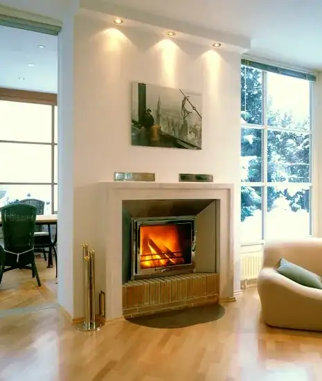

Masonry heaters are stoves with a masonry component ("stones") of 800kg or more. They are installed into a home and are sized after the room size and insulation. (The sizing is quite important as you don't want a stove too strong or too weak, so it is recommended to consult a professional.)
Used correctly, the inside temperature gets quite high, so that the wood burns comparatively cleanly.
Due to their large thermal mass, they are able to store heat and give off a wonderful warmth over an extended period of time (6-36 hours) off-setting the need for other types of heating.
(Usually, you can light a fire in the afternoon/at night and the room will be kept warm until you relight the stove the next day.)
And, for the decorative aspect, they may come with a window.

    We have one of these. We use it to heat the house in winter evenings, after we come home from work, because we leave the oil heating on low. A good one will heat the house in no time, and stays warm for hours even after the fire is out. Ours is a German design with built-in seating. The most important thing is to burn only wood in it. It burns away almost completely and you can put the ash in the garden. Also the wood comes from our garden or from neighbours when they cut down old trees, or waste from the local sawmill. – RedSonja Jan 30 '17 at 09:38
